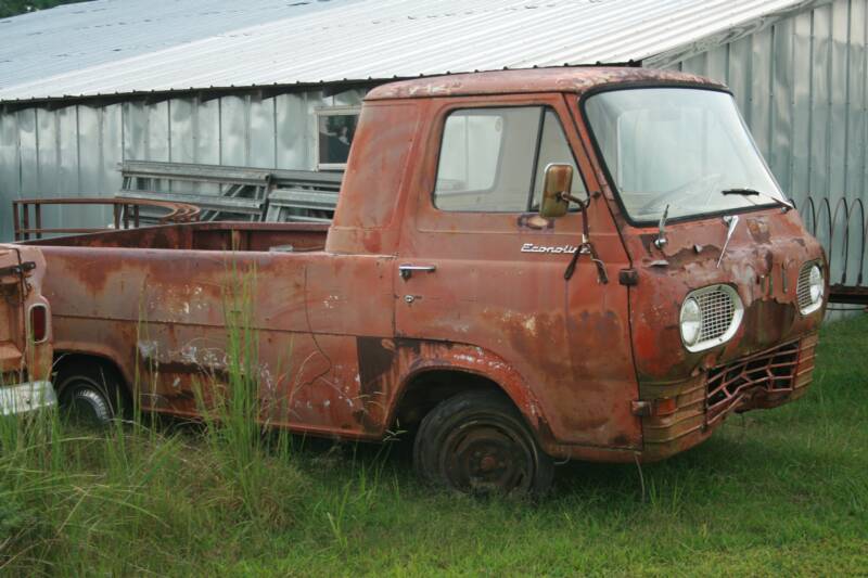

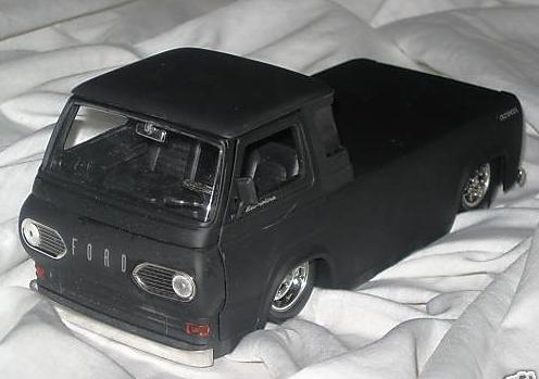

Hello all I am new here so if I do something wrong let me know. I just purchased my newest project at an estate auction. It is a 1961 Econoline Pickup. (I guess it is a 61 from the date on the park lamps and the tail light lens. I have plans to make it look like the Black hot rod in the picture below. I have a donor 95 F-150 for the engine and trans. Here are the numbers I got off the door if anyone can help me out with what they mean.
Warranty #: E10TH478982
Trans: A
Axle : 02
Body : 587
Color : J<-----I know this is some color red but I am not sure what color.
Model : E103
CERT: 85
In the center of the steering wheel: S-22
Thanks for any help you can give.

Welcome to the site..
Sweet old truck..
The trans code would be a 3 sd trans..
The body code was for a 'pickup body style'..
Model code was for Econoline truck line..
Color code was red, not sure if it was Rangoon Red or not?
Axle code may be a 3.89

Thanks man. I know for sure it has a old 3 on the tree in it. From looking around on the Econoline forum site it looks like the J = Rangoon Red and (E10TH478982)E10= E100/ T= engine size/H=Lorain OH Assembly Plant/478982= the month and year the truck was built. Anyone know how to figure the date out from this?

I checked paintscratch.com. According to them, the J code indicates MONTE CARLO RED for all 1961 Ford models other than Falcon and Thunderbird. Perhaps 'all models' means all car models, and does not apply to trucks.
