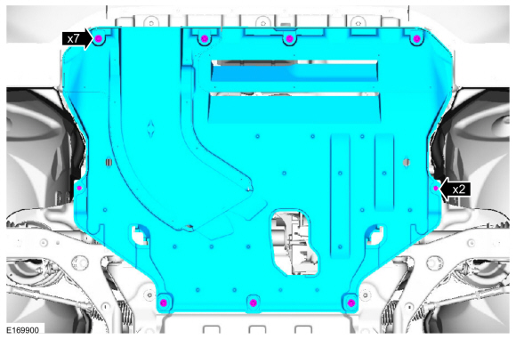

Here are the instructions from ford, I would assume it needs to come out from the bottom based on them but I have not replaced a starter on this engine so I cannot say from experience.
Disconnect the battery when you do this, bungee jump the cable away from the battery so it doesnt happen to touch while your removing the starter.
THE TWO NUTS FOR THE STARTER WIRES ARE VERY LOW TORQUE, you can break the studs super super super easily, I use a 3 inch long ratchet to get minimum leverage and I stop when my arm muscles tighten to apply more force. I probably think about it differently when I do it from experience but I am very aware of my arm muscles feeling loose like they are just unscrewing something by hand.
Starter Motor
Removal
WARNING: Always disconnect the battery ground cable at the battery before disconnecting the starter motor battery terminal lead. If a tool is shorted at the starter motor battery terminal, the tool can quickly heat enough to cause a skin burn. Failure to follow this instruction may result in serious personal injury.
NOTE: Removal steps in this procedure may contain installation details.
  1. Disconnect the battery.
    Refer to: Battery Disconnect and Connect (414-01 Battery, Mounting and Cables, General Procedures).
  1. If equipped.
    Remove the underbody shield retainers and then remove the underbody shield
  1.

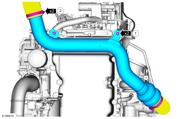

    1. Remove the CAC nuts.
      Torque: 97 lb.in (11 Nm)
    1. Loosen the clamps and then remove the CAC intake pipe.
      Torque: 44 lb.in (5 Nm)
  1.

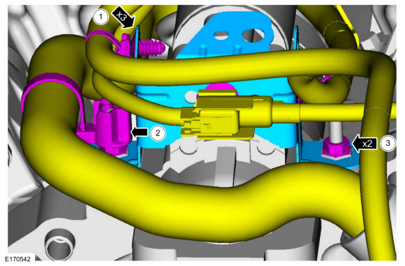

    1. Detach the wiring harness retainers and position the wiring harness aside.
    1. Detach the coolant hose retainer from the starter motor bracket.
    1. Remove the starter motor bracket nuts and then remove the starter motor bracket.
      Torque: 159 lb.in (18 Nm)

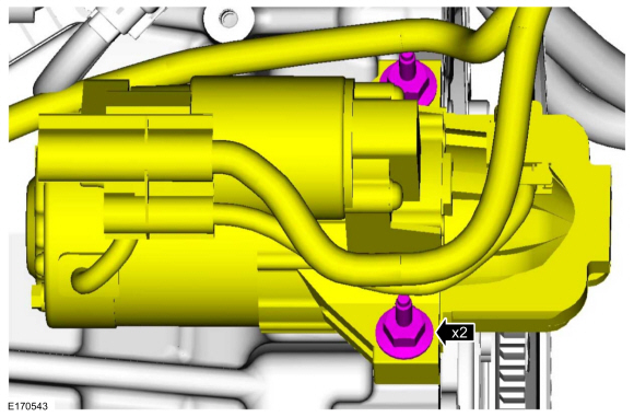

  1. Remove the starter motor studbolts and then position the starter motor to disconnect starter motor the wiring.
    Torque: 26 lb.ft (35 Nm)

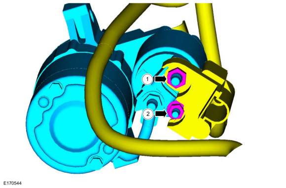

    1. Remove the starter motor battery positive cable retaining nut and then disconnect the battery positive cable at the starter motor.
      Torque: 106 lb.in (12 Nm)
    1. Remove the starter motor control wire nut and then disconnect the starter motor control wire at the starter motor.
      Torque: 53 lb.in (6 Nm)
